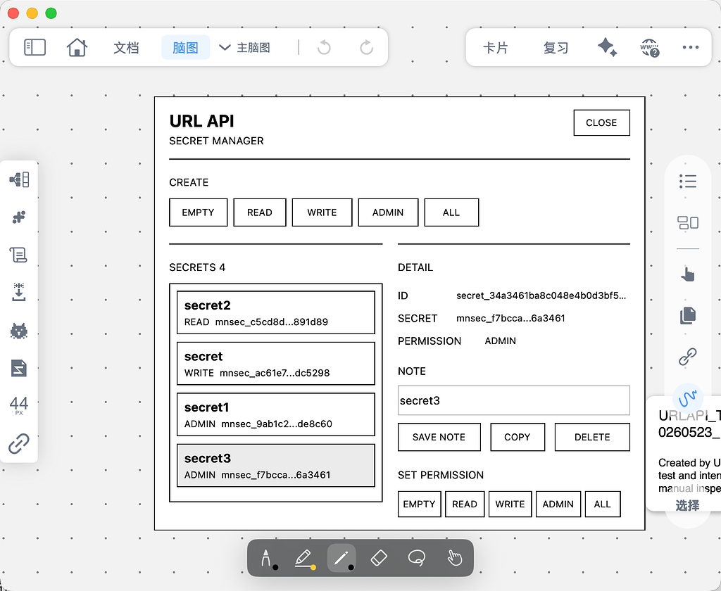

@mono Thanks for the suggestion. I looked at the API for the referenced plug-in and the API allows for @id:noteId. Is there an obvious/easy/intuitive way to get the id for a specific MindMap layer and nodes within a MindMap?
You can navigate to the desired mind map or node and use MarginNote’s “Copy UI State URL” shortcut to generate a link to the current view. Try saving and opening that link in DEVONthink to see whether it provides the navigation behavior you need.

To close the loop, here is information related to the information above. See the section titled “Interface URL Generation & Retrieval”
Use the shortcut Cmd+Option+0 (that’s a zero, not the letter “O”) to copy the current UI state URL to the clipboard. It will generate a link similar to:
marginnote4app://uistatus/UNIQUEID
