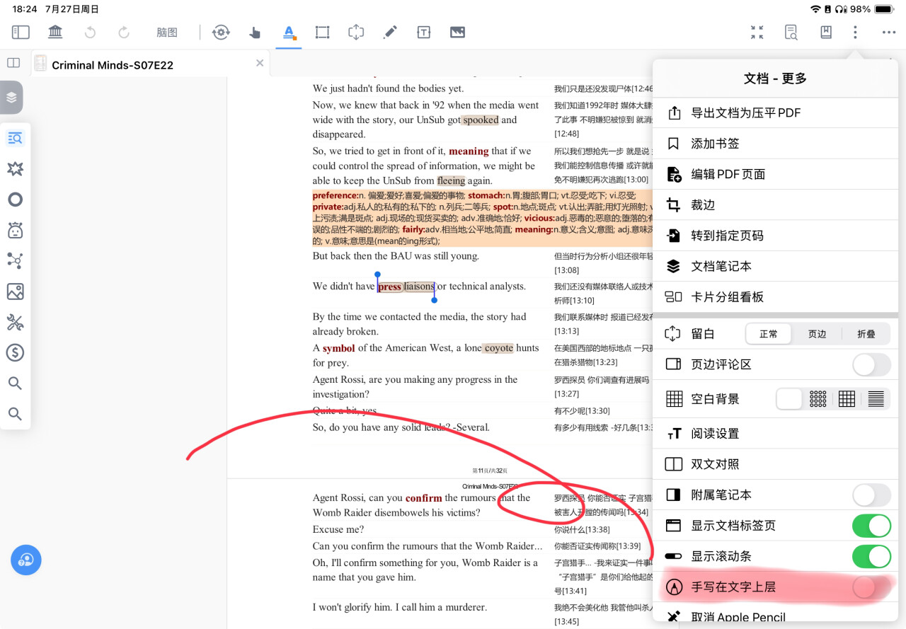

Was this ever fixed? It seems not. I am having this problem. Quite annoying when annotating powerpoints that dont have a white background and my pen is practically invisible wherever I write. Especially for radiology.
Excuse me, have you turned on the option of handwriting on top of text?
where is this option? I’ve never seen it.
You can try this icon. Hope it helps!
