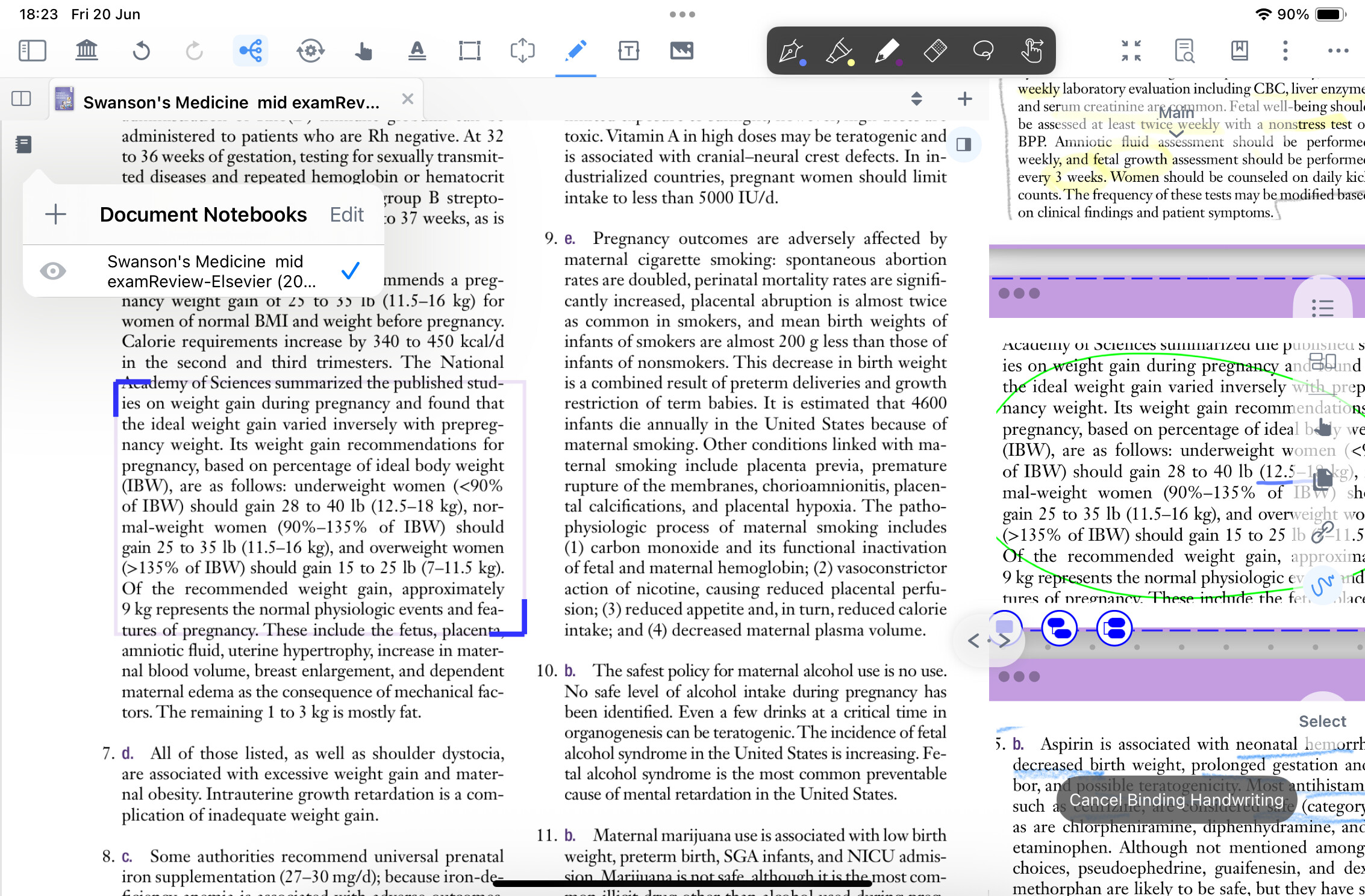

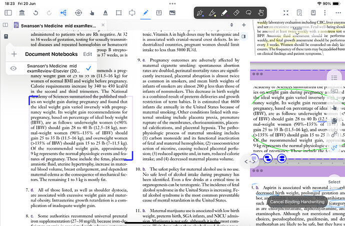

Hello, you can check the “Notebook” icon in the upper-left corner of pdf. It represents adding a new layer to this pdf, and the annotations on the original layer will not be visible in the new layer. You can click to find your previous layers. Hope this helps with your study.

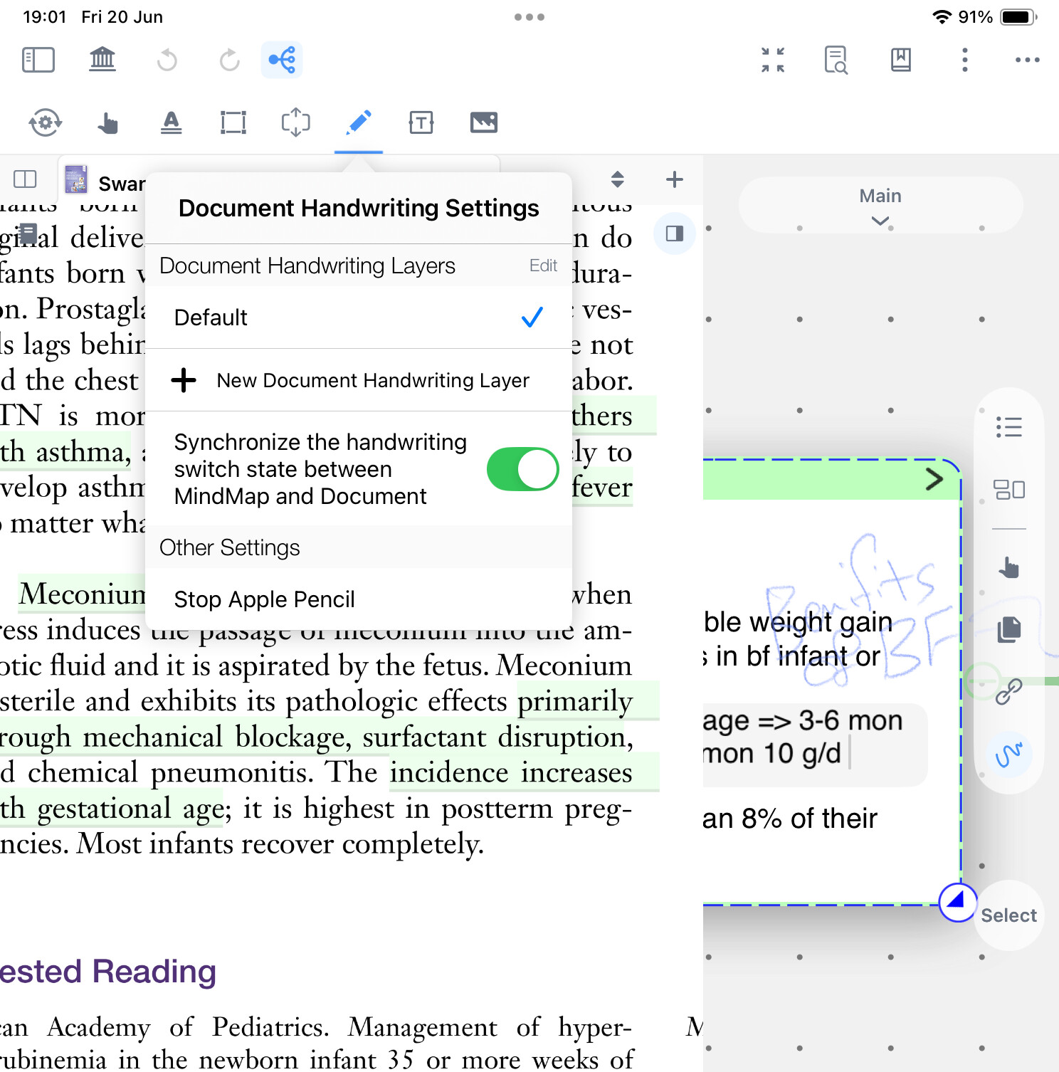

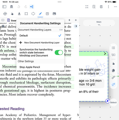

And if you mean the layer here
I am using only the default

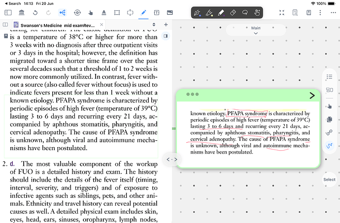

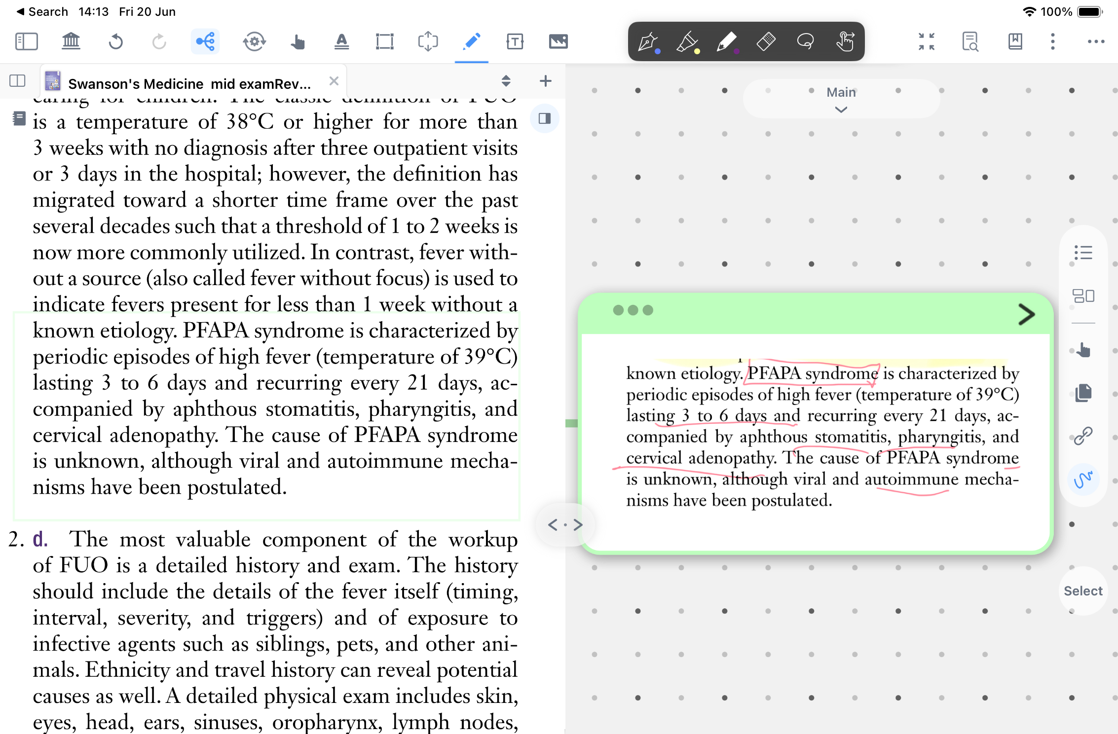

the annotations in the image from “Card Excerpt Tool”
The one which disappeared were from “ Document Handwriting tool”
The handwriting is still present on the cards only not in the pdf
Any handwritten notes outside the card had disappeared
