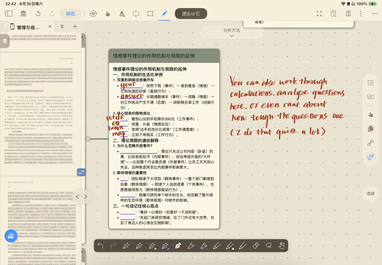

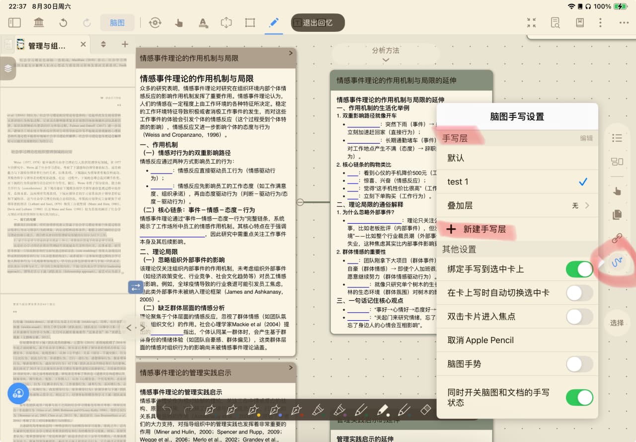

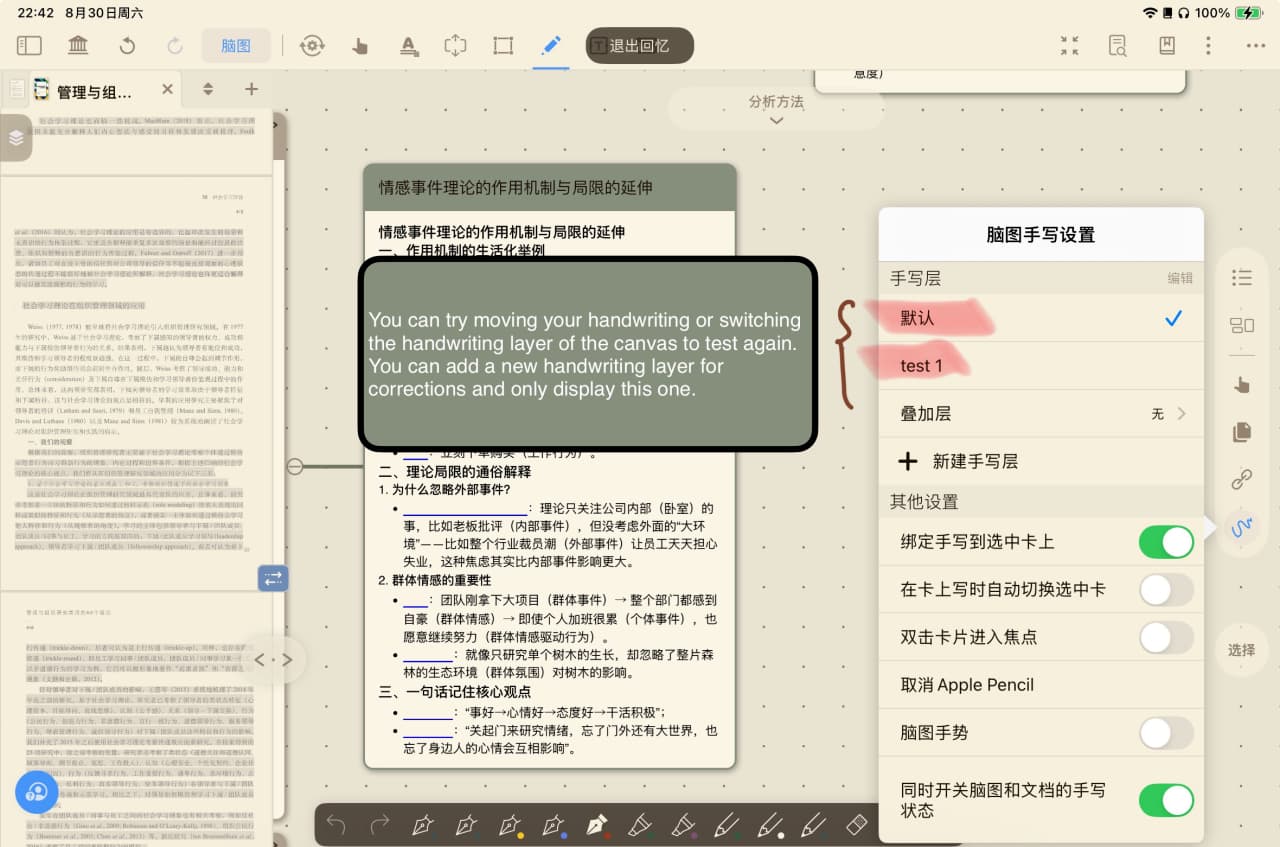

Thank you for the through answer. I am definitely loving the first option and will be using it that way. However, can you provide your workflow for option 3? It sounds very useful but I can’t wrap my head around how that would work. I understand highlighter operates like cloze with recall mode, so both highlight and emphasize cloze are hidden in that mode. My take on your option 3 is you just create a scrap area, write out answer to the cloze section then check the answer?
I’m sorry that I’ve been dealing with a long allergy season, which has made my responses a bit slow. I usually use this method, and I’ve created screenshots to illustrate it—hope it makes sense to you! Of course, please feel free to keep sharing your experiences with me.
