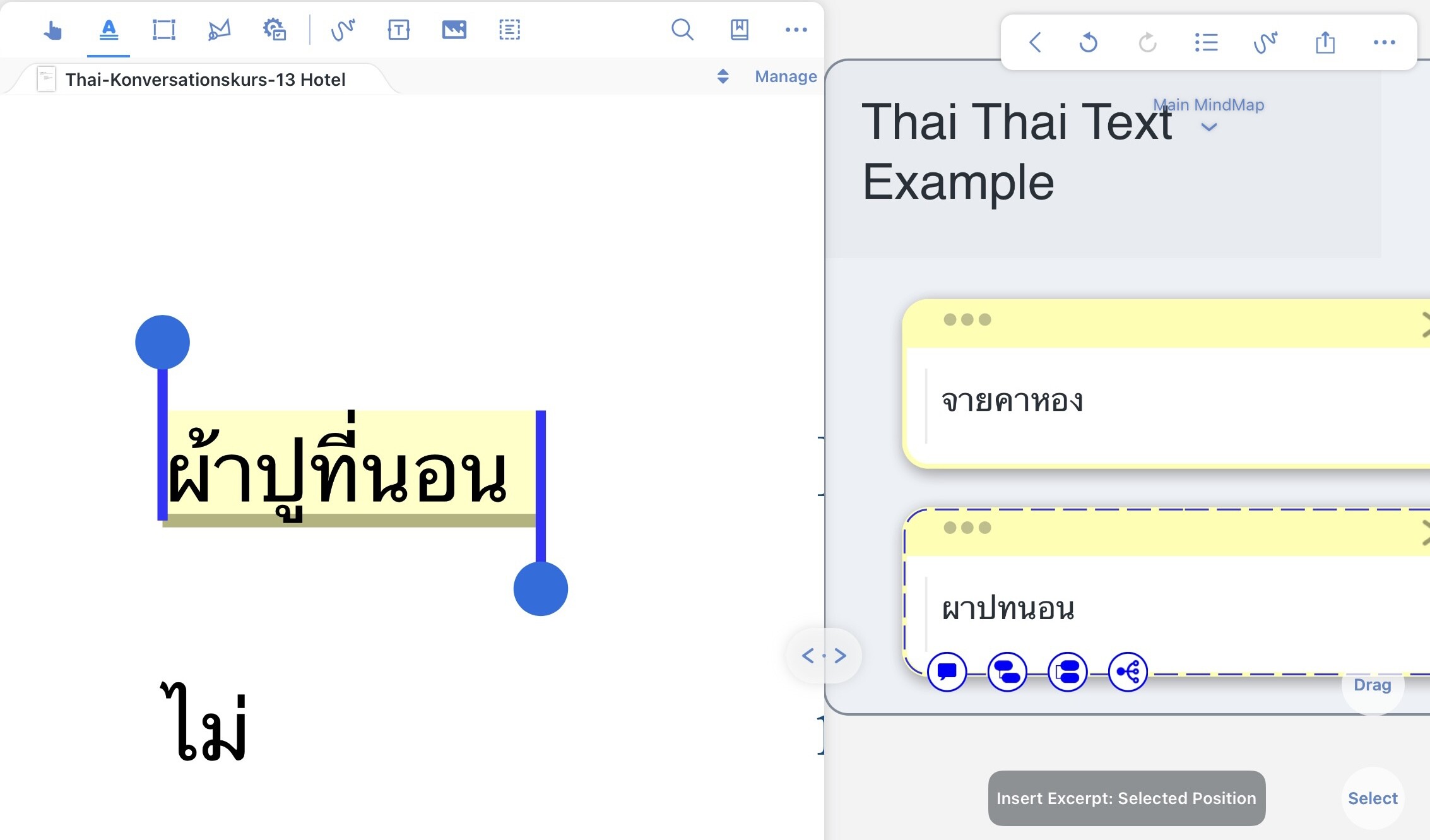

Hi I will add some screenshots to clearify.
Trying to get text copied from the pdf to mindmap erases the unicode combining characters. U can see the tonemarks and vowels above and below the text missing. This also happens when I try to copy and paste inside margin note. I tried both rendering engines for pdf inside margin note. The same pdf files are handled properly by goodnotes, so it should not be a quirky file. I would like to fully use margin note also for these tasks.
Is it normal in the excerpt? There’s a problem with the title, right? You can send the PDF to us
It is a general Problem in excerpt mode. How can I send a pdf file here?
I did some further research and figured out, that scripts like Thai in general can cause trouble with pdf itself, as they need a process called glyph replacement. Maybe all pdfs containing scripts like Thai and Arabic etc.. are kind of messed up by themselves already. When u tell me how it works I can also send you example pdfs containing Thai script.
Also see here: Pdf generated with iOS itself shows a bad effect here:
