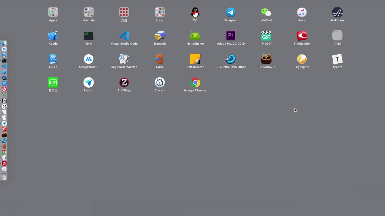

Now I‘m very confused, is JournoProf agree with URL -scheme jump back mechanism. I put a video from our user here, he uses Maestro to generate URL-Scheme from MN and put into Markdown or Voodoopad note, as well as Devonthink.
If MN supports OPML, you will directly have a Markdown file by Pandoc. All these kinds of workflow based on Url Link. This means you have to keep the files stored in the local MN space.
If you guys want to delete MN and just keep the note data with the complete book file, you have to save the PDF and exported-notebook separately. I don’t have the idea about how to make them connected unless just export an annotated—PDF which displays the mindmap on a PDF page.
